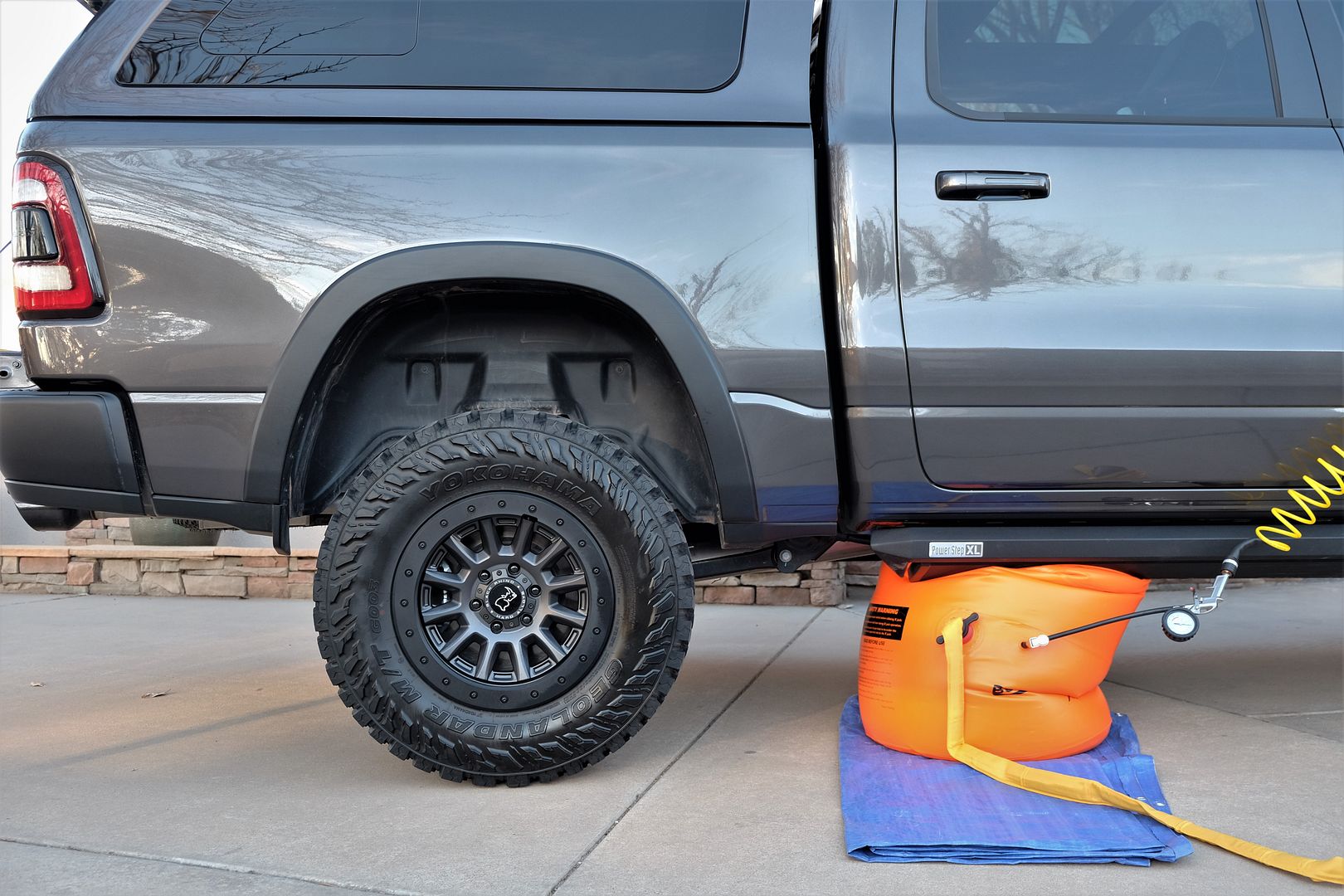

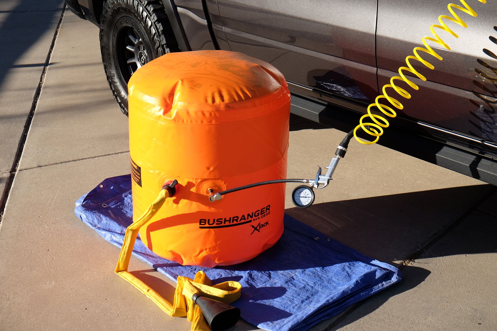

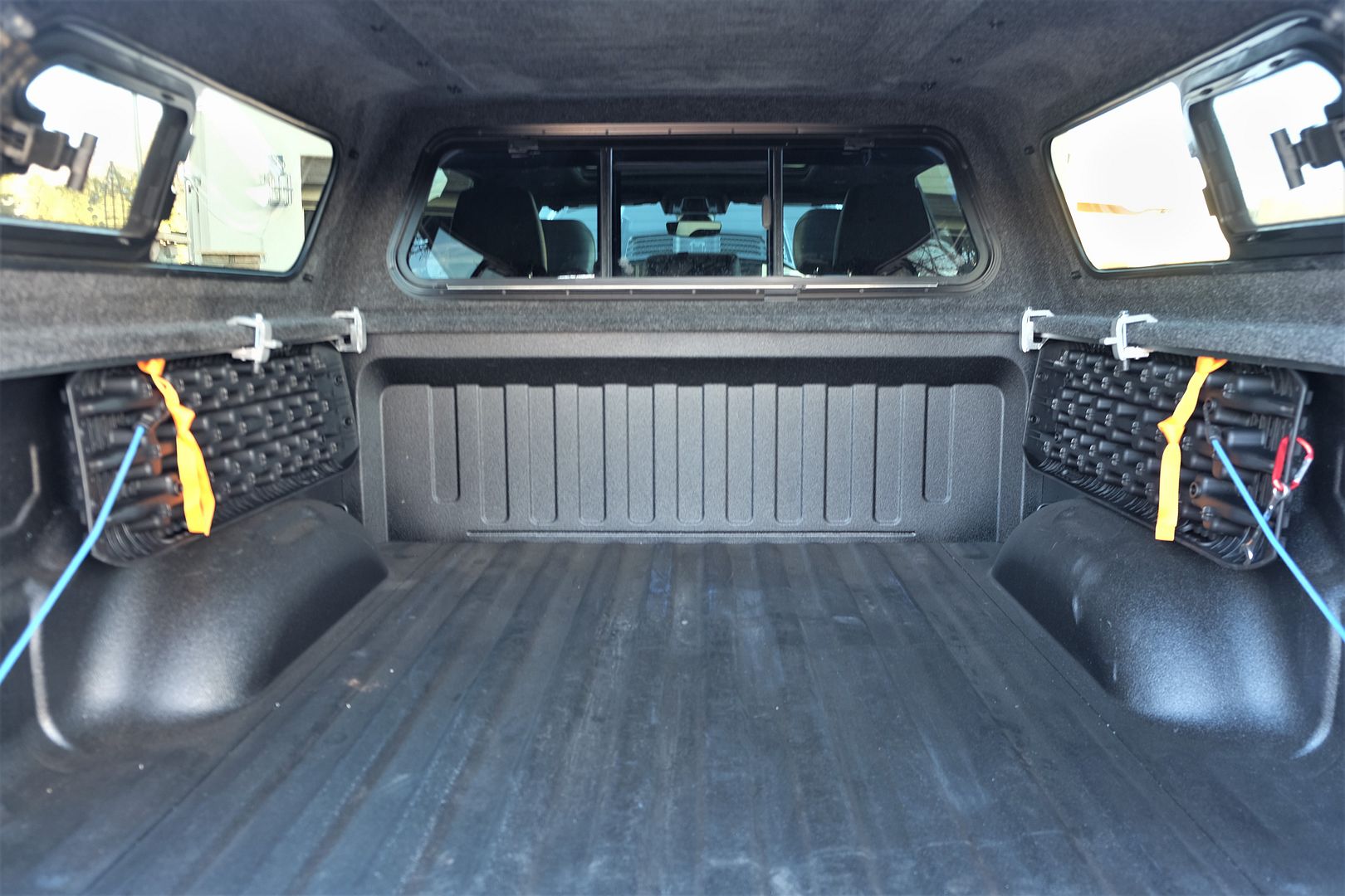

Wife got me a new jack for the truck for Christmas so decided to try it out: it's a BushRanger X-Jack that you can inflate while on the trail using your exhaust or air compressor. Before use, you have to inflate/deflate a few times to get it stretched out and ensure no leakage. After doing that, I tested it under load and figured out I still need some extra lift under the jack as it almost lifted the rear but not quite high enough to clear the lift and larger tires. Luckily, I also received some recovery trax that I now store in the bed of truck and can use underneath the jack to give me another couple of inches to clear the tires.
BushRanger X-Jack inflatable jack system:
ORCISH Recovery Traction Boards secured along inside of bed; great for getting out of loose sand and/or using for providing a base for the inflatable jack:
